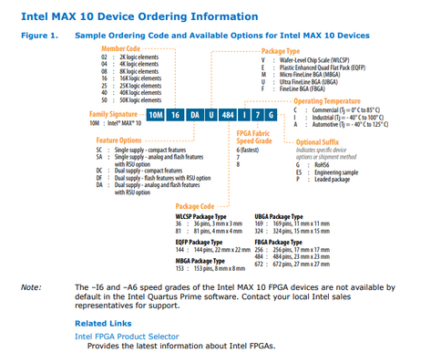

      Here's a step-by-step to find your package type and the dimension:
      1. Find your Package Type and Package Code from your OPN: 10M16SCU324C8G.
      Package Type: U
      Package Code: 324

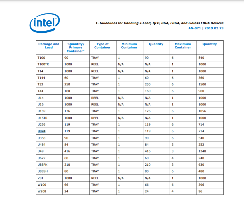

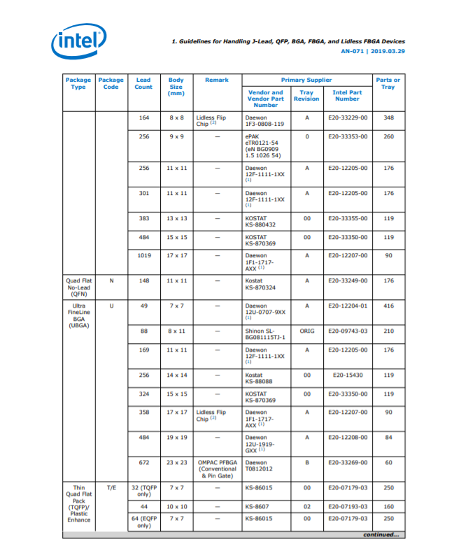

      2. Use this Package Type and Package Code to find your Type of Container, Lead Count and Body Size from this link: https://www.intel.com/content/dam/www/programmable/us/en/pdfs/literature/an/an071.pdf
      Thus, your Type of Container is Tray, and you can find your dimension based on above table with information from your Primary Supplier.
      Hope this answer your question.
