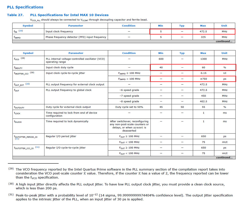

What is the Rise Time / Fall Time requirement of the Input clock to max10.
Consider i am connecting external clock (50MHz - Oscillator) to CLK0P/DIFFIO_RX_L18P pin of max10

    Hi @PG N​
    Rise fall time is does not affect PLL functionality. There is no requirement for rise fall time.
