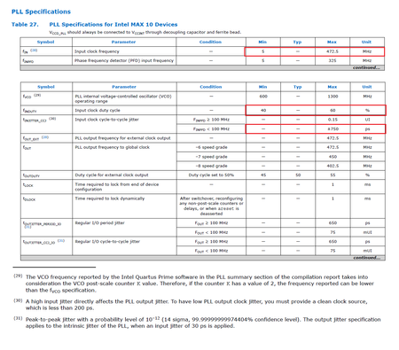

7 years agoMAX10 Input PLL clock Rise Time/Fall Time requirment.
Hi I am Using 10M08SCM153I7G. What is the Rise Time / Fall Time requirement of the Input clock to max10. Consider i am connecting external clock (50MHz - Oscillator) to CLK0P/DIFFIO_RX_L18P pin o...

7 years agoHi @PG N
Rise fall time is does not affect PLL functionality. There is no requirement for rise fall time.
