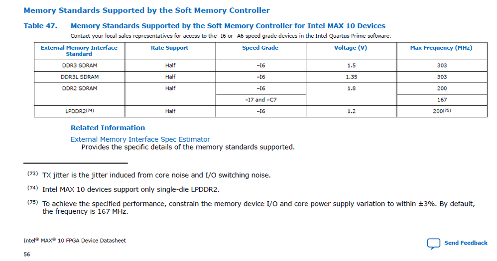

        Kindly confirm again for the below query. Because in datasheet it is mentioned that only I6 grade supports the DDR3, DDR3L devices.
        Attached screenshot for your reference.
        Is 10M50DAF484C8G supports with both the1.0V IO and DDR3L memory devices?

    2. We are using the 10M50DA484I6G in our design. F484 package supports DDR3L memory devices?
    Yes. (refer to page 56 of Max 10 Device Datasheet)
