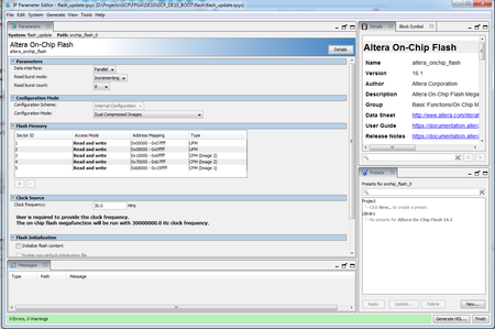

When I create Altera On-Chip Flash IP I get the following addresses sector 3 - 0x10000 - 0x6FFFF sector 4 - 0x70000 - 0xB7FFF sector 5 - 0xB8000 - 0x15FFFF But when I press Generate HDL - i...

7 years agoI am not sure i follow your question , what you mean by what configuration is correct ?

I think I understood. This is in bytes - sector 3 - 0x10000 - 0x6FFFF. But the flash addresses allocated in 32-bit words, so dividing by 4 we get 16383 - 114687.
