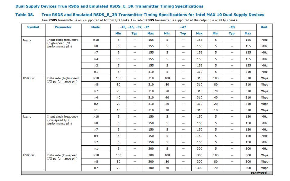

RXie,
The rate value of high_speed & low_speed varies. It's depend on timing specification
For example, Dual Supply Devices True RSDS and Emulated RSDS_E_3R Transmitter Timing Specifications data rate as below:

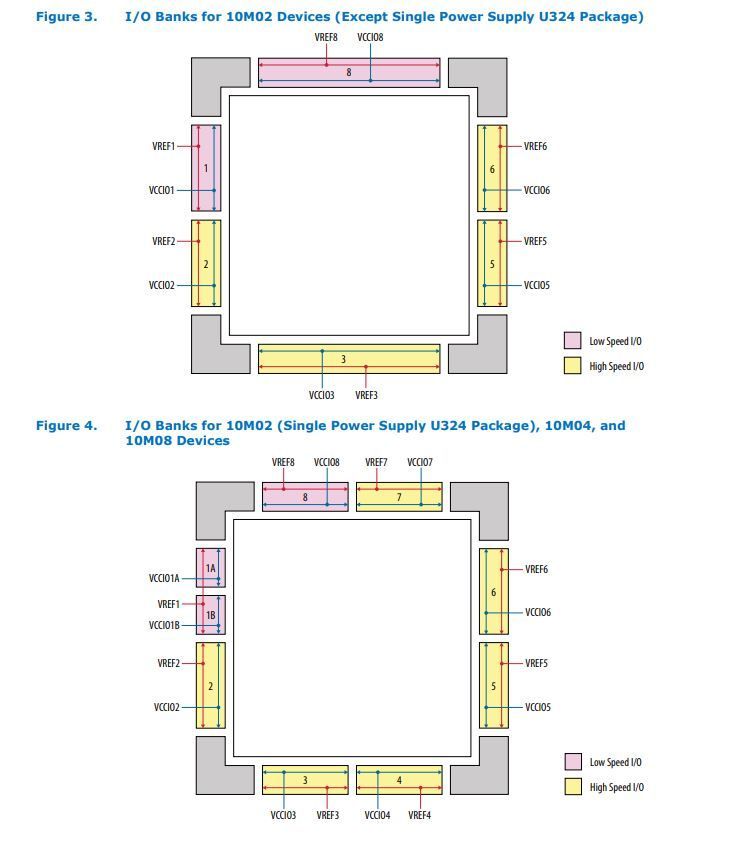

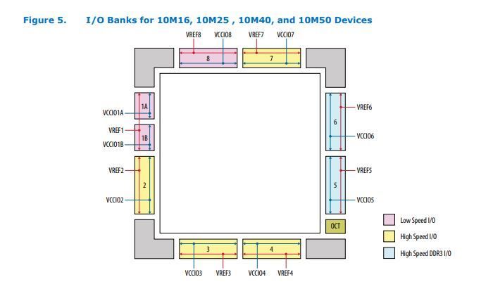

For MAX 10 IO banks location (high speed IO or low speed), you may refer below:
https://www.intel.com/content/dam/www/programmable/us/en/pdfs/literature/hb/max-10/ug_m10_gpio.pdf
For high &low rate, you may refer to MAX 10 Datasheet:
https://www.intel.com/content/dam/www/programmable/us/en/pdfs/literature/hb/max-10/m10_datasheet.pdf
