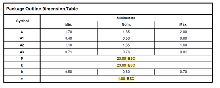

I am using Max 10 device 10M40DAF484C8G in my design. It is a 484-Pin FineLine Ball-Grid Array (FBGA) - Wire Bond. In the package Information the tolerance for body dimension is not provided for foot...

Thank you for contacting Intel Community. Sorry to let you know that Intel FPGA do not provide support for PCB footprint symbols for FPGA and CPLD device families, similar to configuration devices.
However, we will continue the support by providing the schematic symbol which you can download from the link above. You could have the schematic symbol in .olb format from the link below:
