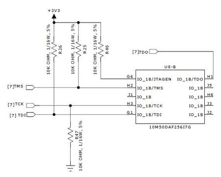

- Everything works in the this custom board except the FPGA programming. We checked all power rails and all is good.
- We only have one USB Blaster and it works when we program an Intel dev kit based on 10M50DA, but it doesn't works when we try to program our custom board.
- Please see the attached picture for the version (software icon)
- Please see the attached picture.
