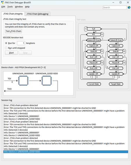

1 year agoJTAG Chain Broken on Agilex 7 I-Series Dev Kit (DK-DEV-AGI027-RA) - TDI Shorted to GND
Hi, I am experiencing an issue with my Agilex 7 I-Series Development Kit (DK-DEV-AGI027-RA). When I run auto detect in Quartus Prime Programmer, it fails with the error message "JTAG chain is broke...
EojinNa
1 year agoFor your information, This issue occurred upon the very first connection of the board. It has never been successfully detected, and therefore, no bitstream has ever been programmed to the device.
