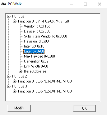

This is a working PCIe status:

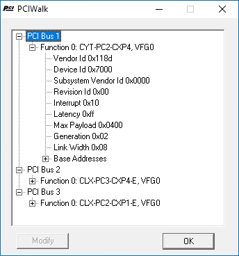

Failing, you can see the latency is 0xff and the Max Payload is different.
Above is the most serious error. As I mentioned some builds work, some have the above issue, and others hang the PC when I try to do DMA to the host.
This shows there is something fundamentally wrong with the build.
