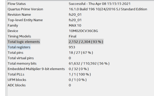

is there any drawbacks if i use 93% logic elements
i use 10m02dcv36i7g
and now i use 93% logic elements
is there any drawbacks?
  • If the design fits and works, then no issues!
    Now if you ever need to make changes or add features, then it might be harder to fit the design in the future in the same device.

    you may also check on your timing, usually high logic elements will have hard time meet timing. But it still varies base on design.
    • qd0090's avatar
      qd0090
      i check the timing
      it is ok
      my clk is 96MHz, the fmax is 123.56Mhz in slow 1200mV 100C model
  • sstrell's avatar
    sstrell
