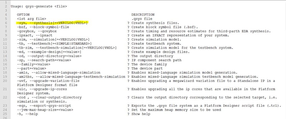

    You have to execute the qsys-generate in the command line terminal instead of the TCL Console in the Intel Quartus Prime software.
    You may specify the language when you execute this command. Attached is the help for your reference

  • ​The project is now being compiled using a script based flow. It shall generate the Qsys system before synthesis. I did include the .qsys file into the design so Quartus automatically generates the Qsys system. However, I noticed that it (automatically) generates verilog synthesis files rather than VHDL files. It is not clear how to specify Quartus to automatically generate VHDL synthesis files instead when .qsys file is included into the project.
  • KhaiChein_Y_Intel's avatar
    KhaiChein_Y_Intel
    You may go to Assignments > Settings > IP Generation HDL preference, set to VHDL
