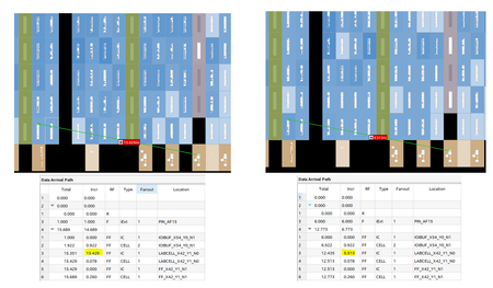

Hi All,
I am using the CycloneV device.
I use logiclock to fix placement position in the same LAB. But when I set different input delays, routing at the same position produces different results. ...

4 years agoMay I know if there is any update or concern on this?
Are you able to work on it?
open01
4 years agoHi SyafieqS,
I still don't have any idea about the correct adjustment of the timing.
Quatus seems to synthesize paths that I think should have the same phenomenon into different delays.
So I'm going to look for other ways to fix this issue.
Thank you very much for your reply.
Best regards.
