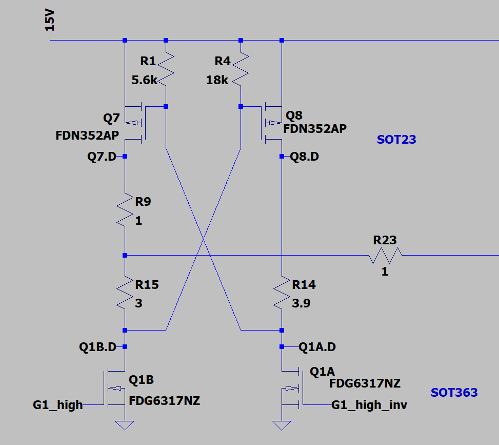

I am working on a gate driver design using the Intel MAX 10 10M08SAU169I7G. The FPGA is driving the signals G1_high and G1_high_inv in the attached schematic. The supply rail available (so far) is 3.3V. At this voltage I can select drive strengths 2mA for LVCMOS and 8mA for LVTTL. If I reduce the voltage to 3.0V, I can select drive strength 16mA for both LVCMOS and LVTTL. I have been able to translate the IBIS models to spice.

      VOH (high level output voltage) is specified as VCC-0.2V (min) for LVCMOS. The output buffer is not able to fulfil this at 16mA drive strength with a supply voltage of 3.3V. I understand this. I am not interfacing to an LVCMOS device but a pair of mosfets with a threshold voltage of 1.5V(max). I wonder if the limited choices for drive strength at VCC=3.3V has to do with which logic standards can be met more than which drive strengths (output impedance) can be set with no damage to the device?

      To be clear: To be able to drive the mosfets fast, I need low output impedance. The MAX10 device I use needs 3.3V to work, so I have this supply rail in the design. It seems that I would need to generate another supply rail at 3.0V to be able to set the output buffers at full (16mA) drive strength. This seems strange. I do not understand how setting full(16mA) drive strength at 3.3V could damage the output buffer assuming that I keep the switching frequency and thereby losses low.
