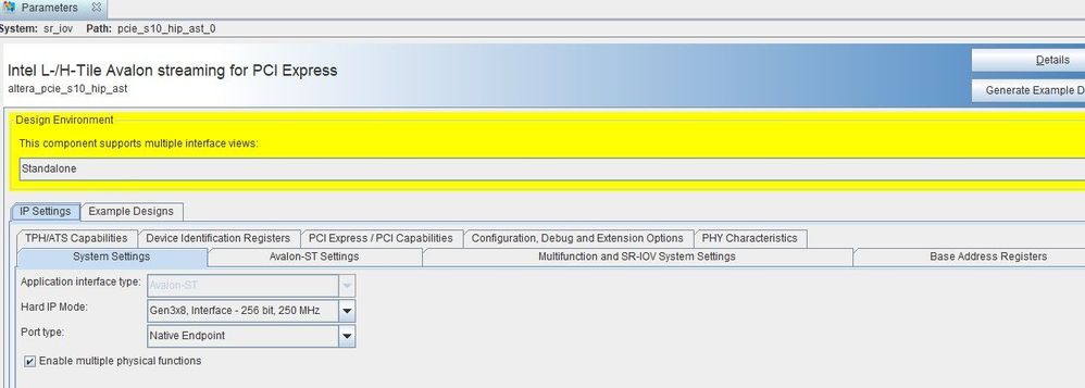

I try to generate SR-IOV example refer to the "Intel® L- and H-tile Avalon® Streaming and Single Root I/O Virtualization (SR-IOV) IP for PCI Express* User Guide " to running on the Stratix® 10 FPGA Development Kit " DK-DEV-1SGX-L-A " . When I select Device " 1SG280HU2F50E2VG" , there have option to enable the sr-iov ,

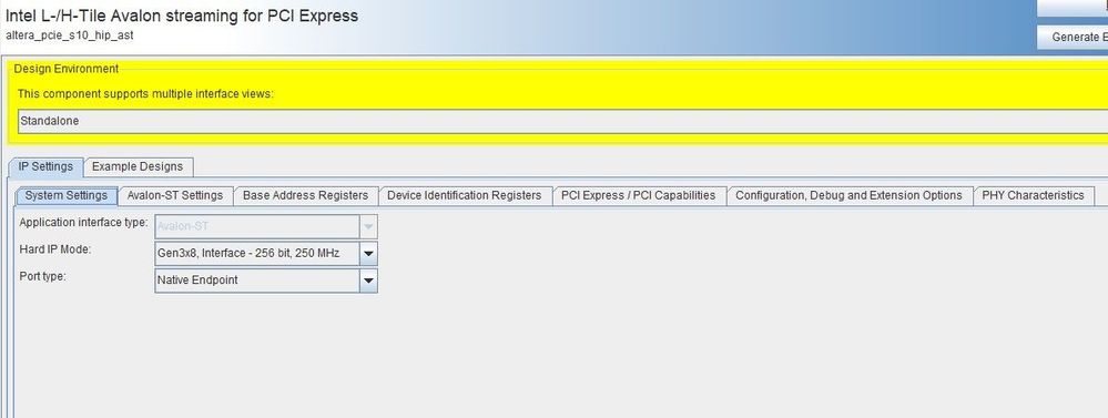

When I select Device " 1SG280LU2F50E2VG" , there have not option to enable the sr-iov .
Is the device 1SG280LU2F50E2VG does not support SR-IOV?

Hi Mark,
Yes. Single Root I/O Virtualization (SR-IOV) support is added for H-Tile variants only.
You may refer to the release note https://www.intel.com/content/dam/www/programmable/us/en/pdfs/literature/rn/rn-s10-pcie.pdf

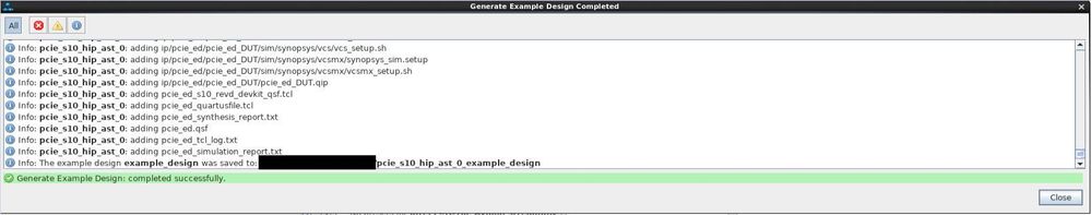

I tried to create an example design using the settings that you have provided and keep others as default. The design example generation is successful.
May I know which software edition / version you are using? Can you use the latest version?
