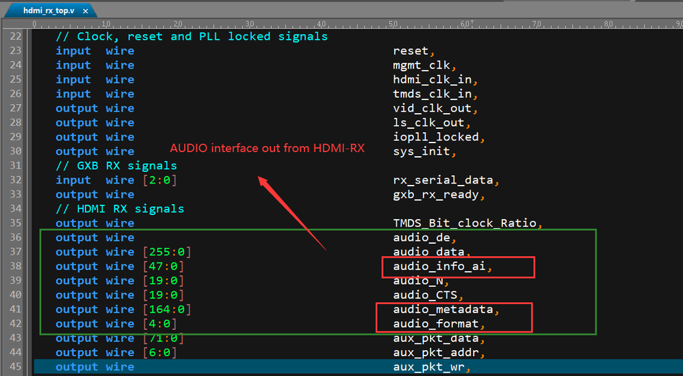

In Arria 10 Device, How to convert to I2S format from the audio extracted from HDMI IP core?
hdmi-in ----> HDMI-RX IP(arria 10) -----------> PCM1770 --> analog audio out
HDMI-RX EDID set support:1ch, 48KHz fs, 24bit audio in;
from HDMI-RX IP signals:
1bit audio_clk = ls_clk[0];
1bit audio_de = datavalid;
256bits audio_data = i just need LSB 64bit (1ch, L & R)
PCM1770 : audio output chip
input signals:
SCKI : almost named : MCLK
LRCK = WS = audio fs;
DATA = audio sample data, serial
BCK = DATA bit clock;
support 24bit sample audio data;
BCK = 64fs;
I don't have any ideas to implement this module.
Question:
Q1 : Do I need to recover the accurate audio sample clock?and HOW
i know :128 * fs = f_TMDS * N/CTS. from hdmi spec.
Q2 : Does audio_data[63:0] is the DATA what PCM1770 need? No need to convert?
Any answer may be helpful to me.
I hope you can give me some advice, Thank U!
