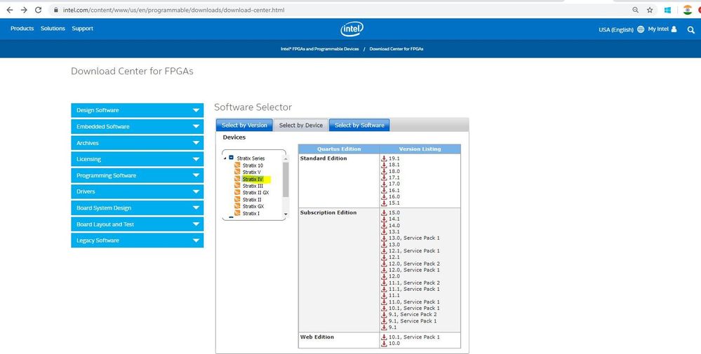

"can I use the 19 version of the software to program the FPGA in DE2i-150 board?" ---- ---- -- You can use any of them to program the FPGA DE2i-150. please refer the below screenshot & link,
https://www.intel.com/content/www/us/en/programmable/downloads/download-center.html
