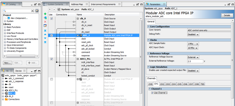

How to use only one channel on ADC port Max10
I have an ADC core

When I used the whole port ADC1_IN1 - ADC1_IN8 was no problem.
Now I want to use only one channel - ADC1_IN1 so I set only CH1 active in the core.
However I get the errors while compiling

How can I resolve the problem?

      • EEren's avatar
        EEren
        Well... I found the answer - If you use bank 1A for ADC, you cannot use the bank for GPIO.
        At least something stays rock solid - the support is traditionally lame on the forum.
