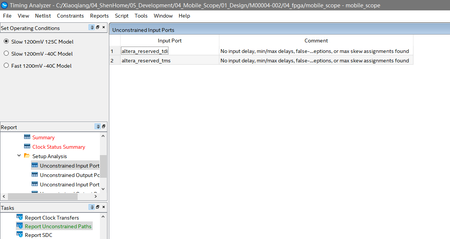

4 years agoHow to set timing constraint for JTAG
- 4 years ago
Here is how I put timing constraints on a JTAG interface (I do it in an .sdc constraint file):
# JTAG setup for Altera USB Blaster set_false_path -from [get_ports {altera_reserved_*}] -to CPUCLK set_false_path -from CPUCLK -to [get_ports {altera_reserved_*}] create_clock -name altera_reserved_tck -period 40 {altera_reserved_tck} remove_input_delay [get_ports {altera_reserved_tdi altera_reserved_tms}] set_input_delay -clock altera_reserved_tck -clock_fall 3 [get_ports {altera_reserved_tdi altera_reserved_tms}] remove_output_delay [get_ports {altera_reserved_tdo}] set_output_delay -clock altera_reserved_tck 3 [get_ports {altera_reserved_tdo}] # Cut off paths between async clock domains remove_clock_groups -all set_clock_groups -asynchronous -group {CPUCLK} -group {altera_reserved_tck}
