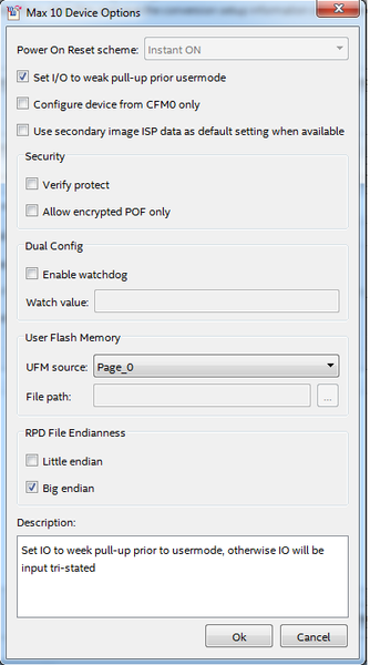

I have a bootloader in CFM0 sector. I feed a rpd file through serial, after uploading the file to the FPGA flash it reports success. But when I switch to CFM1 it fails and goes back to CFM0. I suspe...

You will need to always check on the "On Chip Flash" IP to make sure that the sector you are programming is the correct CFM location.
