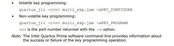

According to my interpretation of AN 556 to use the command line to program the .ekp file requires conversion to a .jam file. But the note provides no way of generating this second file via the command line interface, only by opening up a GUI in the software.
How do I script generating a .ekp file and programming a device with it?

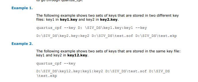

    Hola JHaye4,
    To generating .ekp:
    To program :
    Cheers,
