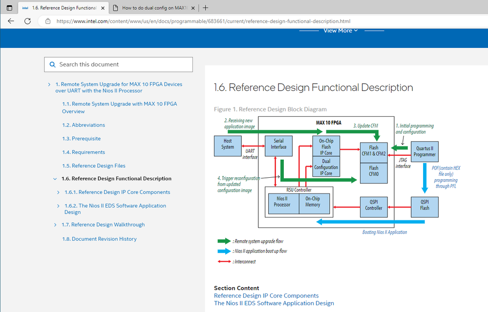

How do I do a dual configuration on MAX 10 device not using JTAG, we want to do remote device update over SPI, it doesn't look like this is available?

    your approach is well feasible. You'll basically use the provided On-Chip Flash and Dual Configuration IP and implement everything else in user logic.
    You don't necessarily need a RAM buffer, just write data to flash as it comes in. A FIFO might increase throughput though.

    We do not have external QSPI and probably dont have room to have Nios Processor, can this be done with a state machine and other logic, meaning use state machine to copy incoming image to ram, then copy ram to flash with a state machine?
