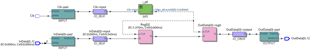

I have stripped my whole design down to two flip-flops (see attached quartus_project.zip) and I still struggle to meet timing, even if I heavily relax the timing constraints.
By closely following Intel's AN433 and free training course, I understand that for best timing performance I should instantiate a PLL (specifically, an IOPLL configured in "source synchronous" mode - green block above) and my timing constraints should be defined like this:

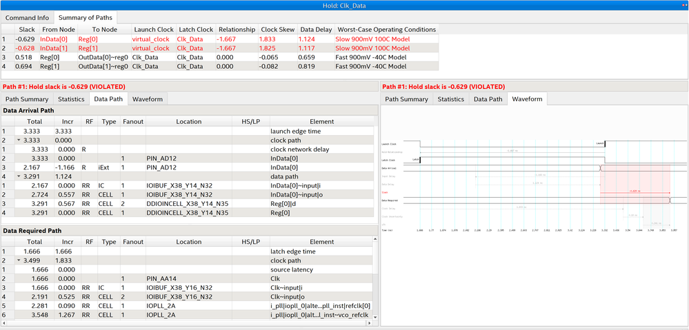

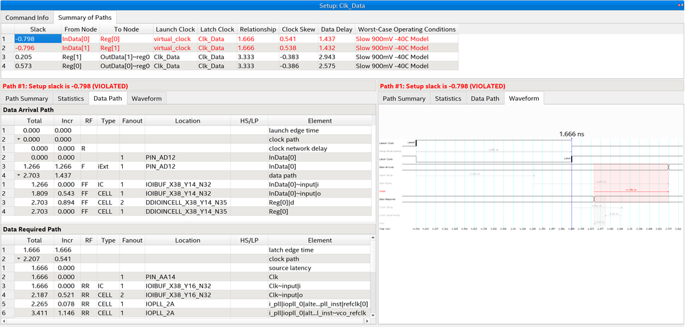

      Both setup and hold timing fail on the first flip-flop. Here is the setup timing analysis:
      And here is the hold timing analysis:
