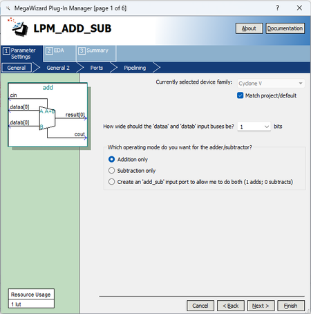

In the verilog code, I think you have to connect dataa and datab to input ports instead of constant 1'b1 / 1'b0. If connect to input ports you'll get map viewer result like below pic:
For example, taking single lpm_add_sub megafunction original map viewer result, the result like pic below:
If connect lpm_add_sub megafunction dataa and datab to constant, you'll get the result like below pic instead:
Sheng

Thank you for such a detailed answer. Through these methods I have solved my problem. Thank you again.
