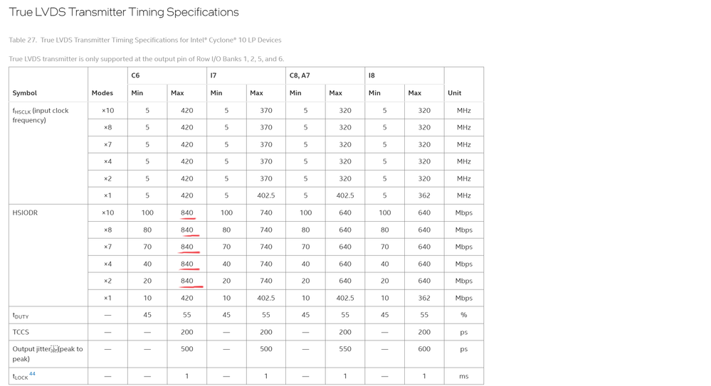

Thank you for your response. I've got a such result like in a picture bellow. Is it the top limit?
- AqidAyman_Altera
Thank you for reaching out Intel FPGA Community.
You can refer to the datasheet where it has outlined the High-Speed I/O Specifications.
Refer to this link https://www.intel.com/content/www/us/en/docs/programmable/683251/current/high-speed-i-o-specifications.html
