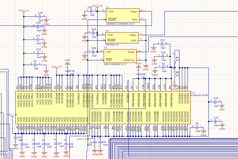

I suspect power supply since I can't find a very good datasheet material on the power supply requirements beyond a table of pin voltages. One thing that's made the process of making my own development board tricky is datasheet fragmentation. I haven't been able to find one datasheet with all the info I need but instead find bits and pieces in multiple sheets and not all at the same time or in the same place. A schematic of the power wiring is included below.

Please check your pin connection by referring to pin connection guideline : https://www.intel.com/content/www/us/en/content-details/654351/cyclone-v-gx-gt-e-sx-st-and-se-device-family-pin-connection-guidelines.html
regards,
Farabi

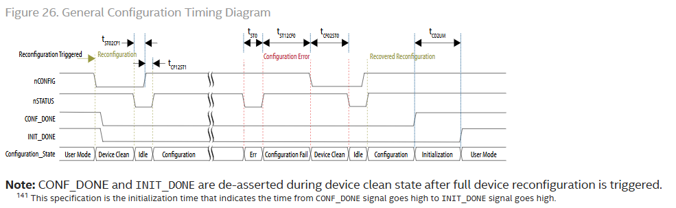

To make sure your power supply to FPGA meeting the FPGA requirements, could you please check below signals?
1- nCONFIG(active low) - turn low-then-high when FPGA completed power ramp up and start to enter configuration mode
2- nSTATUS(active low) - turn low-then-high when FPGA enters configuration mode.
3- CONF_DONE (active high)- turn high when FPGA completed configuration, and enter user mode.
If you dont see activity of above signals, the power supply is not meeting device requirements.
regards,
