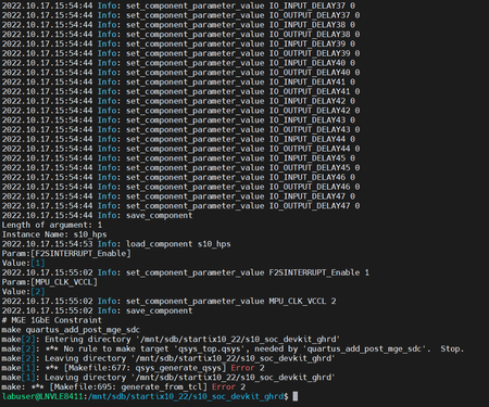

Hi All, I've facing an issue for quite a while now running the GHRD for the stratix 10 SoC. Here's a screenshot of the problem space:
A quick recap: I downloaded Quartus Prime Pro 22.1,...

I managed to figure it out. My Ubuntu VM has 4 GB of RAM and the process that was constructing the HPS ip was consuming 8GB of RAM thus the process was being killed. I increased my RAM to 16 GB and the issue was solved.

And to summarize this issue more after digging again the last couple of days, whenever i run the construct_hps.tcl script it just times out and exits. Actually anything to do with the HPS times out, for instance i took a section of the script and try to see if it would run and it seems to time out immediately.
