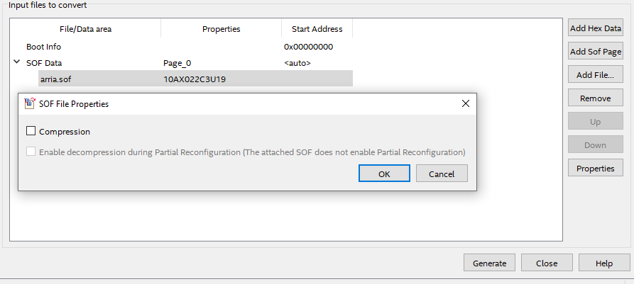

My board is using Arria 10 + MT25QU256 (ASx4 mode). I'm using Quartus 20.1, standard licence.
I'm carefully following this topic
https://www.intel.com/content/www/us/en/programmable/documentation/bhc1410500804155.html#bhc1410500756183
But at step 7.i, there is no " Bitstream Encryption" dialog box and no "Generate encrypted bitstream" available but only an option for compression.
Also, what should be indicated for "programming file type"? None of jbc, jam, svf or ekp file formats are available.

    Per you description, I believe you have followed the right steps.
    1. Can you attached the screenshot of SOF file properties?
    2. Are you using a temporary license?
    Aiman
