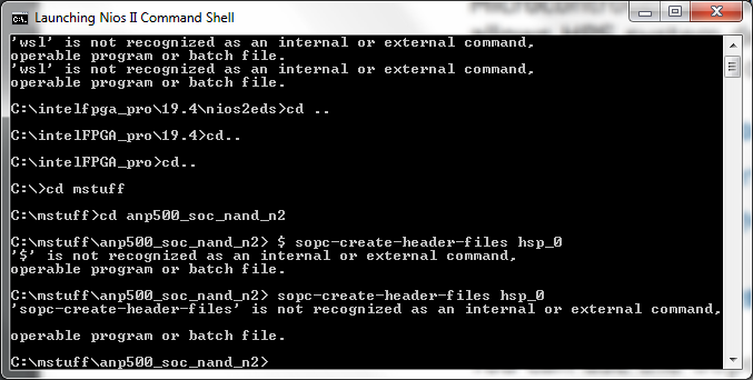

I'm trying to generate .h file for Arria 10 HPS/Soc project and it didn't work, see below.
I've tried commands
$ sopc-create-header-files hps_0.sopcinfo

    You are using a windows command prompt which won't work since the sopc-create-header-files is a shell script.
    Instead you should use a cygwin shell to generate the header files. You also need to have sopc-create-header-files on the path. Watch this video.
