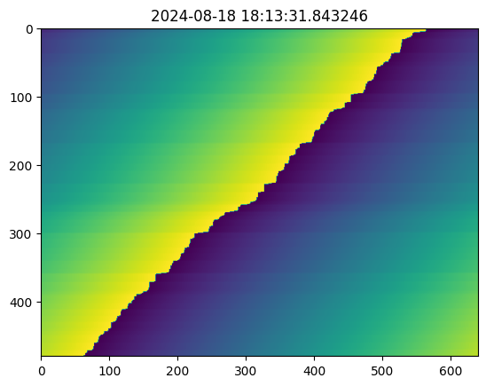

The problem comes when the data leaves the Frame Buffer and enters my CVO. The picture appears as shown in Figure 1. It turns out that the output lines are missing some pixels and analysis with signaltap showed that this happens from 2-4 line of the very first frame.

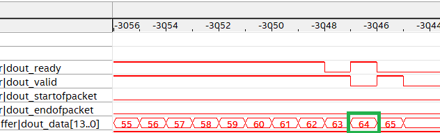

Also with the signaltap I was able to find one of the places where data loss occurs. Figure 2 shows how for a pixel with a value of 64 the dout_valid signal is set to 0. Then dout_valid returns but with a pixel value of 65. It is exactly this pixel that is then missing in the row because it will not come into fifo where one of the write conditions is the dout_valid signal must be at 1.
My CVO module has ReadyLatency = 1 for the Avalon Stream protocol. The Frame Buffer has the same value. In the Avalon® Interface Specifications I did not find an explanation for me, maybe I am misunderstanding something. But supposedly even during ReadyLatency cycles after dout_ready signal falls there should be dout_valid signal in 1 if Source wants to send data.

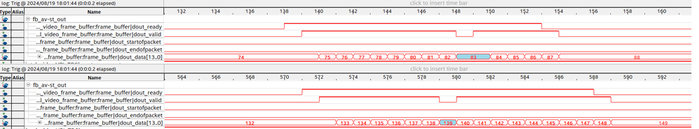

  • Yarko's avatar
    Yarko
    There is one more example:
    - The value 83 is transmitted correctly and is hold when the valid signal drops.
    - But the value 139 is not recognized because the valid signal is 0.
