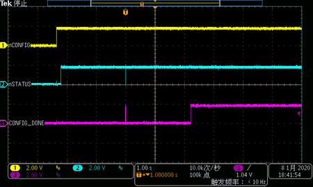

6 years agoFPGA on the configuration of nStatus pull down
During the configuration process of the customer, a low-level pulse appears on the nStatus signal, causing the Config_done signal, which has been pulled up, to be pulled down again. NStatus signal i...

Usually, nStatus pin is set to low if it detects a configuration error. This error could be CRC error.
My recommendation to you is try a simple design (like LED blinking or any simple design) on your board. And observe whether the nStatus behavior is consistent or not.
Kindly try it out and let me know the result.
