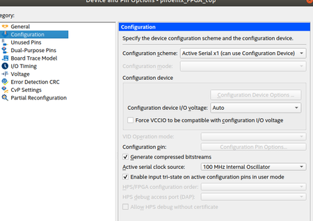

hi, we are using 10AS016E4 on our boards, and use the EPCQ-L(MT25QU01G) for AS configuration. Below is the setting for the configuration. For my device, the rbf file is 11466204 byte, with 10...

configuration speed in ASx1 mode is 1 bit per clock cycle, your calculation misses factor 8.
If the AS flash interface is wired for ASx4, you should select ASx4 configuration scheme. Also enable compression in programming file generation when using .jic files.Rgards,

3 years agothis is really a stupid mistake for me. thanks for your reply!
