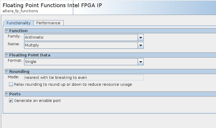

I have a design with multiplication and addition. I have used a multiplier and adder "Floating Point Function IP". I am wondering how do I create a logic so that multiplier IP is used first, and then the result is fed to adder IP. Any suggestions?

    I would suggest you change the function name from Multiply to Multiply-Add. Multiply-Add can performs two input multiplication followed by addition.
