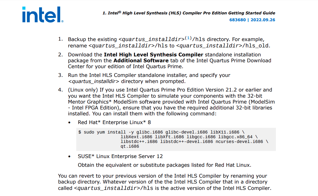

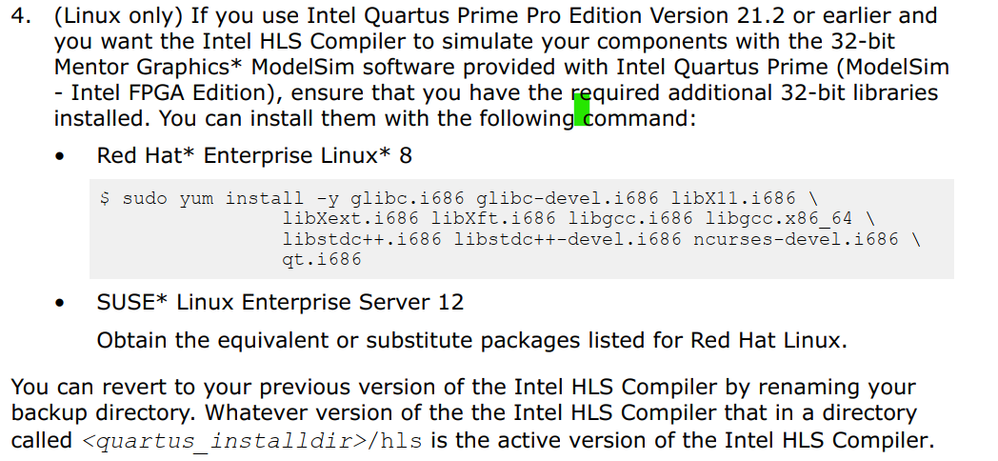

- hareesh
follow the bellow document. execute in that way. and attached counter example design file try with that.
if you are facing same problem after that please download HLS compiler and install it and try same procedure.
