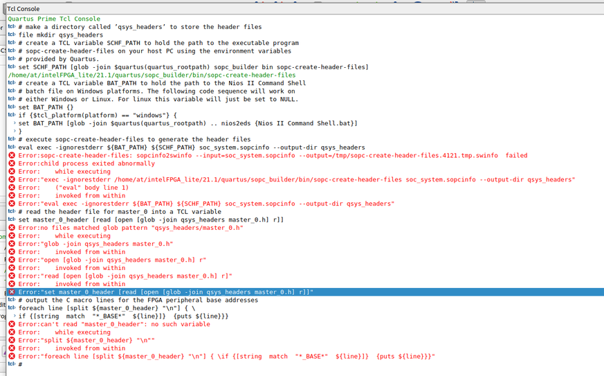

I am encountering a similar issue in trying to complete the "Build a custom hardware system" tutorial for a DE10-Nano board. The following are the version of relevant softwares I am using.
OS : Ubuntu 22.04
Quartus: Quartus Prime Version 21.1.0
In trying to generate the header file using the tcl script provided in the tutorial (https://www.intel.com/content/www/us/en/developer/articles/technical/build-a-custom-hardware-system.html) I get the following errors:
The code I entered is a direct copy paste from the tutorial.
