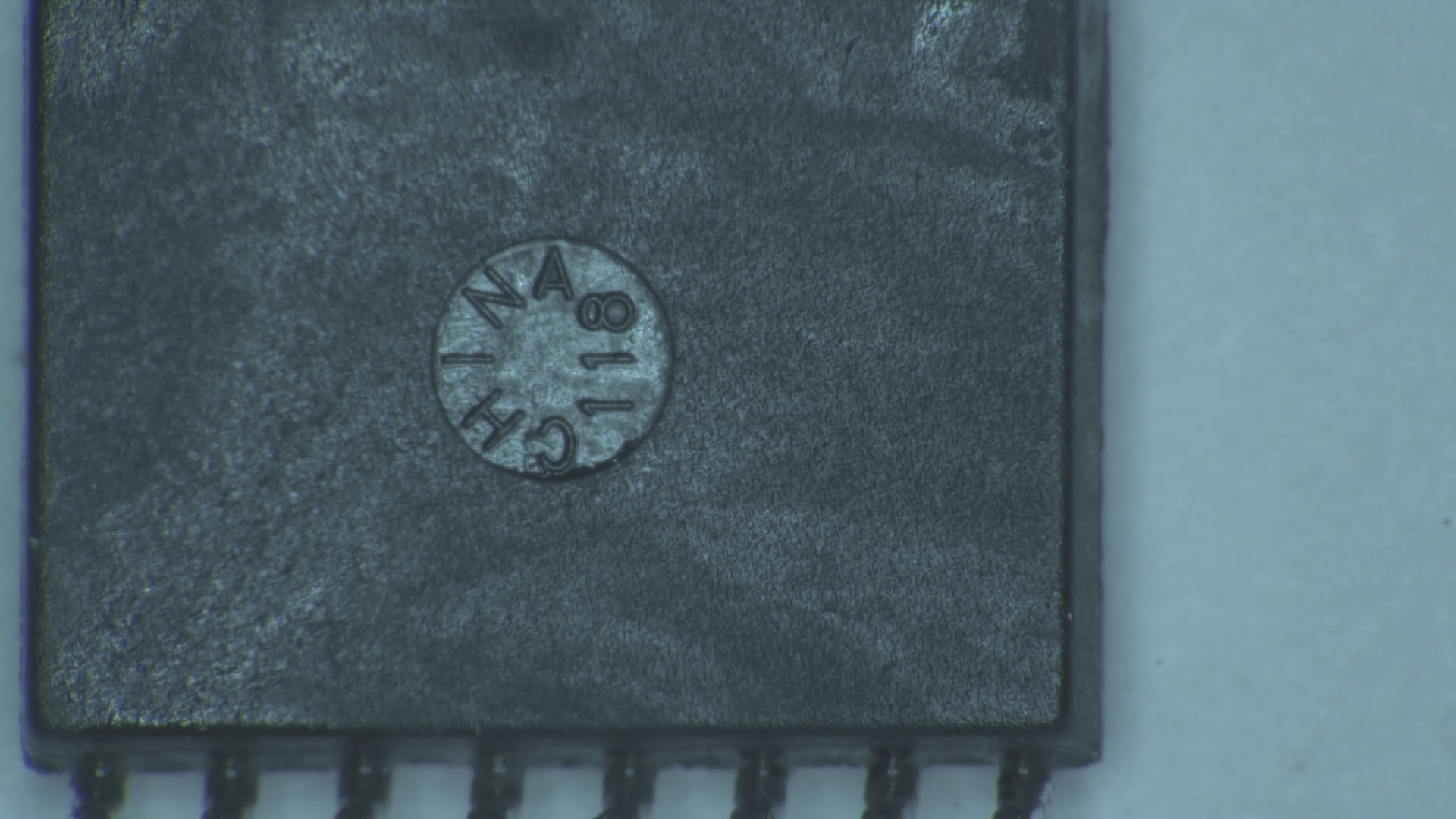

Full marking of problem ICs (see attachments):
1) EPCS128S OP11E V5 CHN 801 (CHINA 78 in the circle from the bottom of the case)
2) EPCS128N GO156 VS CHN 805 (CHINA 118 in the circle from the bottom of the case)
I believe that Intel is interested in identifying the reasons and taking arrangements counterfeit products, the damaging reputation of the company.
Anyone ever faced such a problem? these chips are fake?
