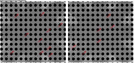

你好!
EP4CGX150DF31I7N
This model was purchased here, and cracks were found after X-ray. Is it normal?
赵锋
4 years agoHello,
we have purchased 100 of them, and sampled 11 of them, and found that all of them are in this situation, which will affect the function operation?

4 years agoHello,
I am sorry to hear you are facing this. Please contact your distributor about this.
Thank you
