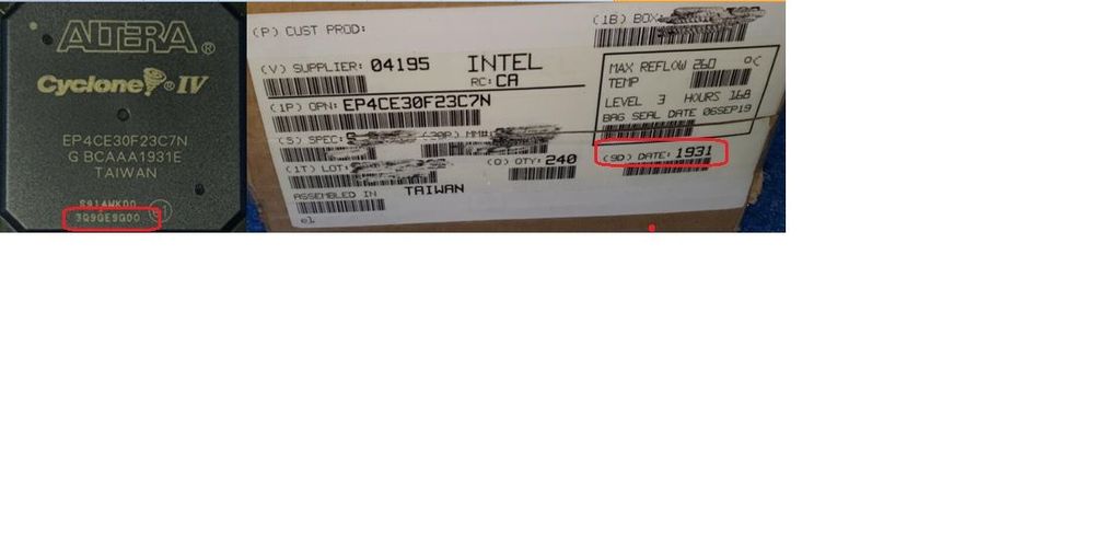

Dear Support,
Please advise if it is possible to encounter different date code from the device top marking and the box label?
Please refer to attached photo for reference. Thanks
- NurAiman_M_Intel
We do not receive any response from you to the previous answer that I have provided. This thread will be transitioned to community support. If you have a new question, feel free to open a new thread to get the support from Intel experts. Otherwise, the community users will continue to help you on this thread. Thank you
- NurAiman_M_Intel
I believed you are referring to the wrong line for the date code. Below are the top marking format that you can refer:
https://www.intel.com/content/www/us/en/support/programmable/articles/000083214.html
Hence the date code shown on the device and the box are the same.
