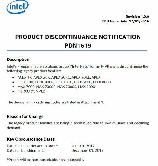

Hi need to know that the parts YTEOL years to EOL for EPM7064SLC84-10, EPF81188AQC208-2, EPF81188AQC208-3 and EPM7064STC44-5N. If they are EOL how any replacements available ??

All of the device listed was EOL in 2017. There is no drop in replacement for the part number. Kindly consider to use the latest FPGA eg; MAX V, MAX 10 for latest design.

You are about 6 years too late. They went EOL back in 2017. Ref Intel PDN 1619 ...
You might want to look at the Microchip/Atmel ATF1504 as a drop-in replacement for the MAX7000 EPM7064S part.
I know of no direct replacement for the FLEX8000 series parts, maybe others do.
