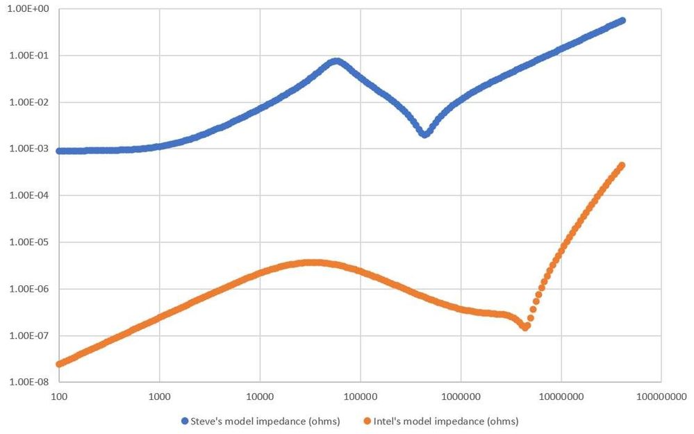

    there are so many reasons why this is an unacceptable solution. I am happy to talk about this on the phone but these problems are indicative of everything wrong for virtually all power IC suppliers. So i am not picking on you, but this is really bad.
    1) the model is junk. see below. If the output impedance is not right NOTHING about the closed loop response will be correct (like step load). The model is not close as you can see by the impedance in the XLS tool. I am not sure how someone is supposed to know not to use this model in AC or transient? You should withdraw it.

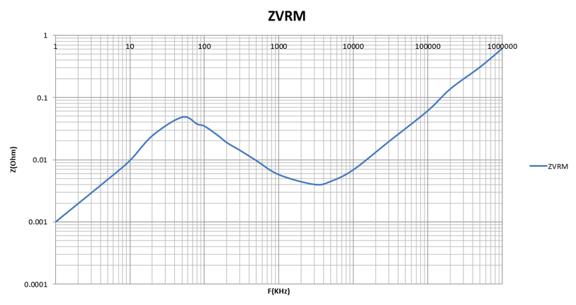

      As i can notice that the orange model that you compare with is not from the stability tool that i attached which has a closer impedance to your measurement.

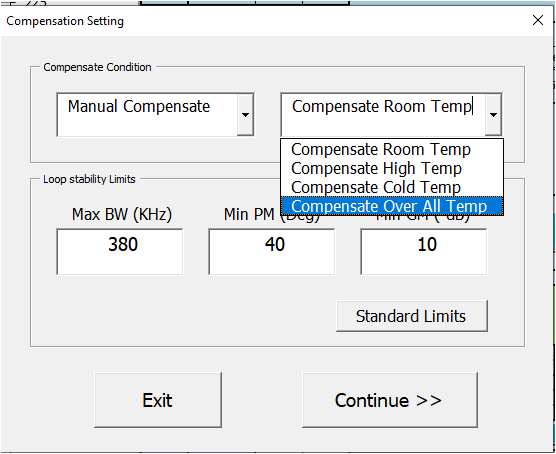

      As i explained in my previous response, that the stability tool will check all the circuit variation and corner cases when you click the compensate button.

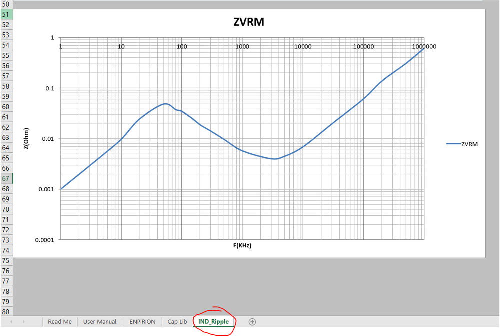

      Whatever, the LTSPICE model and the stability tool are accurate to represent EN6337, but the stability tool presented bode plot maybe is not same as what you measure where the present bode plot at the nominal case but when you click the compensate button the tool will check all the other corner case.
      I have enabled the Zout_closed loop model on the attached stability tool, please check IND_Ripple tab.
