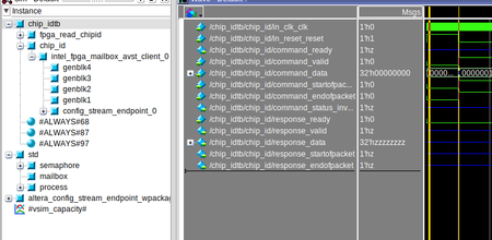

Check out this link https://www.intel.com/content/www/us/en/docs/programmable/683510/22-4-1-0-2/device-family-support.html, there's a note there:
Note: You cannot simulate the Mailbox Client with Avalon® Streaming Interface Intel® FPGA IP because the IP receives the responses from the SDM. To validate this IP, Intel recommends that you perform hardware evaluation.
Example design link:
Probably have to use on-chip debug tool signal tap to view the simulation check image below:
