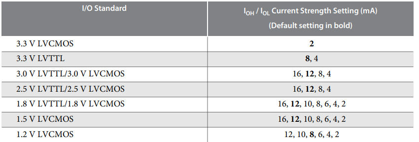

Driving strength of 10M08SCE144I7G
We are using 10M08SCE144I7G in our design and need an information. Do we have different driving strengths other than 2mA for this part?

    You find supported drive strength for I/O standards in MAX 10 Handbook
