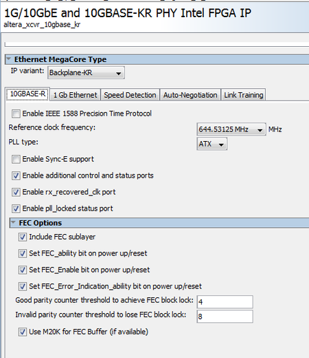

Hello, FPGA-engineers.
I have a problem with implementation RX equalization in 10GBASE-KR PHY IP in Arria V GZ. My project works correctly with Auto-Negotiation (reconfiguration PMA), Link-Train...
