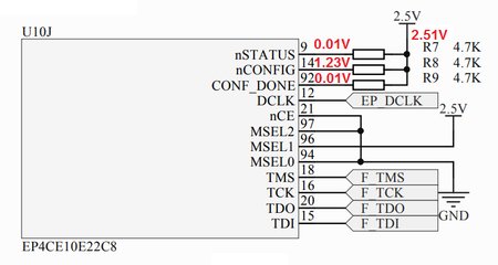

Hi I'm developing my own FPGA board using a Cyclone IV E EP4CE10E22C8N but when I use the USB blaster JTAG, it says it cannot scan the device chain. I have measured the configuration pin voltages (nS...

The nCONFIG should be connected to VCCIO as mentioned in pin connection guidelines.
