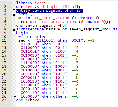

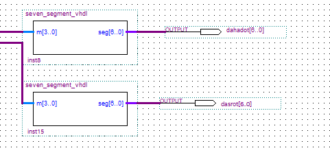

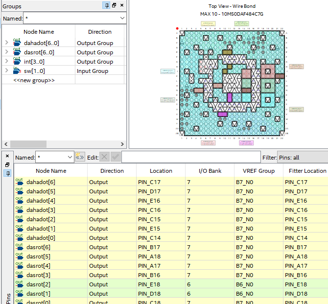

I’m trying to connect my pins to the seven segment display and every time I try to run the sof file the segment doesn’t go on.
I checked the pins correct place.

    Without seeing any part of the design, there's really no way to know what's going on.

      the code have done seccessfullu compliation and i made the pin connection according to DE10-lite manual.
      • BXia's avatar
        BXia
        How did you assign your input pins? And did you program the DE10_LITE_Default.sof in DE10-Lite CD-ROM/Demonstrations/Default to verify function of the segments hardware?
  • BXia's avatar
    BXia
    You'd better program the default demo's .sof in de10-lite cd-rom, then check if the HEX display normally.
    Or maybe your code doesn't work.
