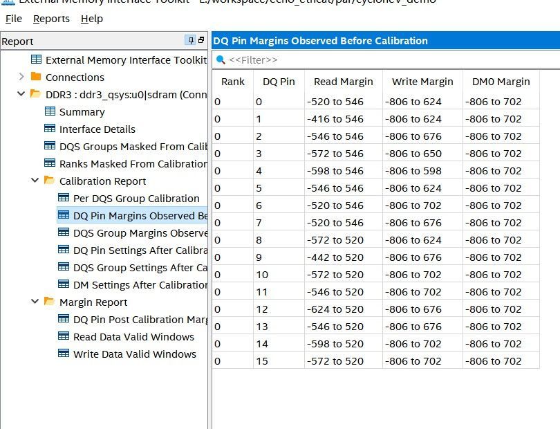

May I see your DDR3 IP setting from the GUI?
You can provide the snapshot of the IP GUI and put it in this forum.
Can you share the calibration report from the memory toolkit for calibration fail?
You can generate the report by clicking on Generate All Report in the toolkit.

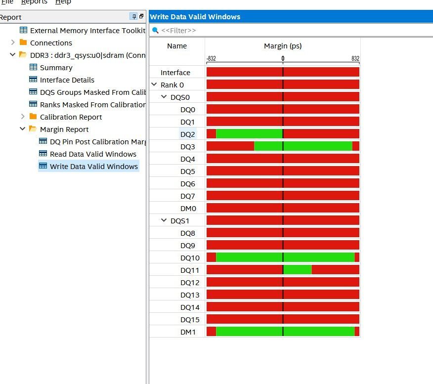

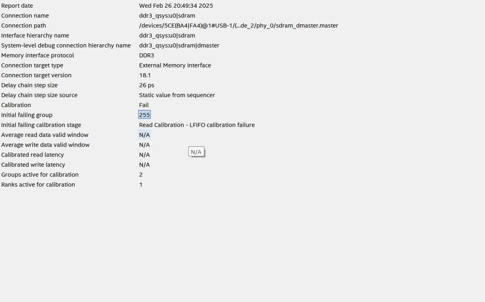

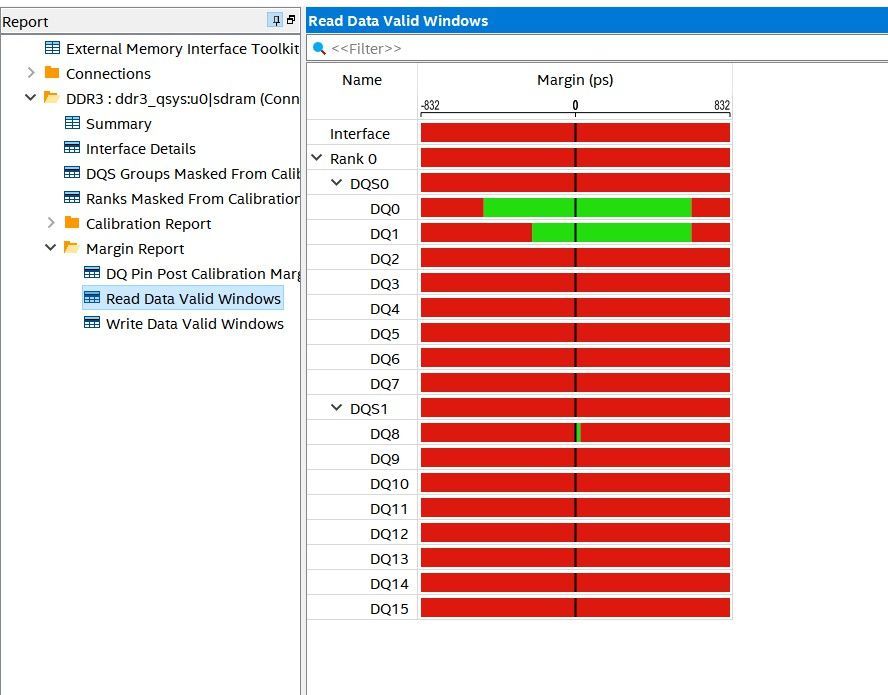

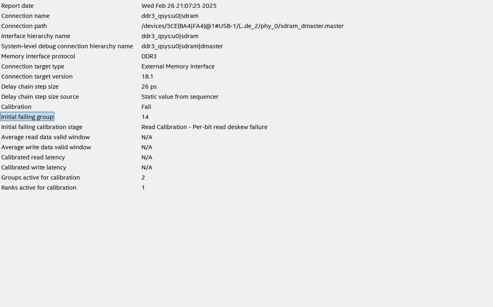

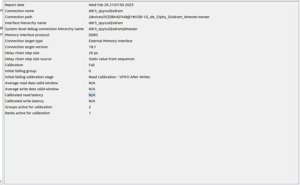

zhangxianyu
1 year agonow my init sometime is sucess,sometime is fail
sucess is follow picture
fail is follow picture
