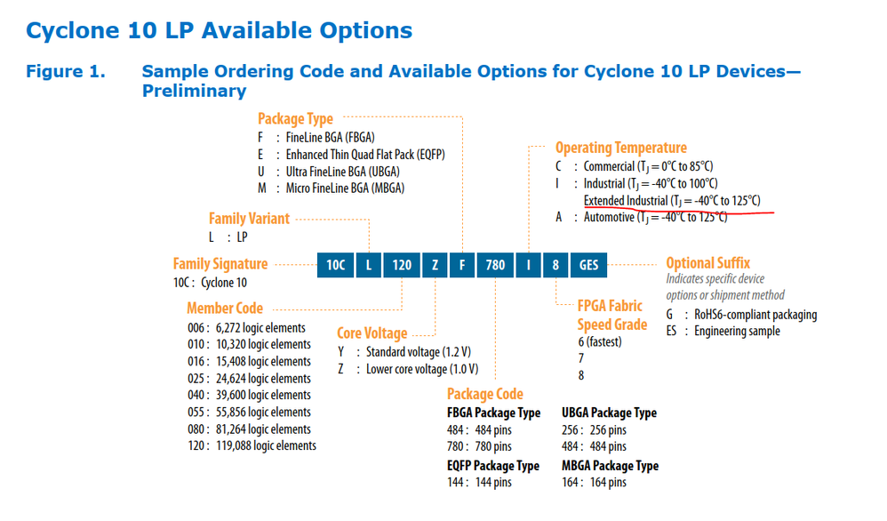

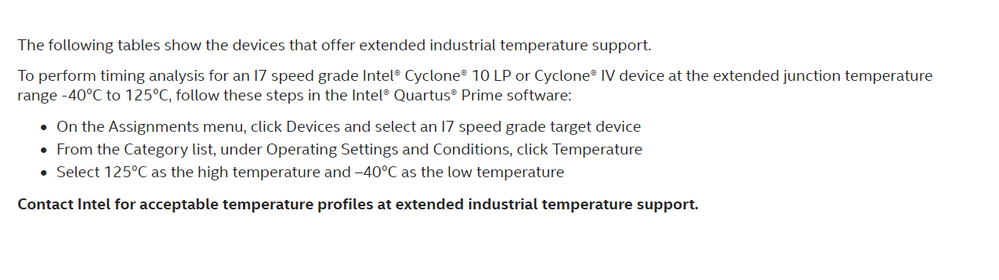

Cyclone10LP extended temperature support
Hello experts,
I'm using Cyclone10LP 10CL016YU256I7G on my products. On the datasheet, we found this chip can support "Extended Industrial" temperature.
At this page(https://www.intel.com/content/www/us/en/products/programmable/temperature.html), it is described that how to perform timing analysis for an I7 speed grade at the extended junction temperature range -40°C to 125°C". But I did not find the related setting on Quartus Prime lite and standard version(21.1).
My question is: how to evaluate if this chip can operate at extended temperature in my application? Can I get some guideline? thanks!

    Hi Shawn,
    Can you share how you do the setting?
    As per check, the settings are available inside the Quartus for the device.
