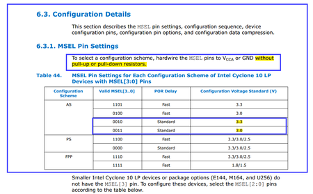

7 years agoCyclone10 do not support AS config scheme when Configurationn Voltage Standard=2.5V ?
Hi there, we are using 10CL055YU484C8G, ALL 8 bank VCCIO=2.5V, VCCA=2.5V, VCC_core=1.2V We planned to use AS config scheme with standard POR delay, however, From latest Cyclone10 LP handbook, sect...

7 years agoCould anyone help on this? Thanks!
