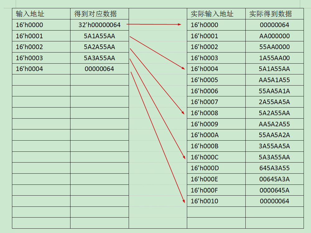

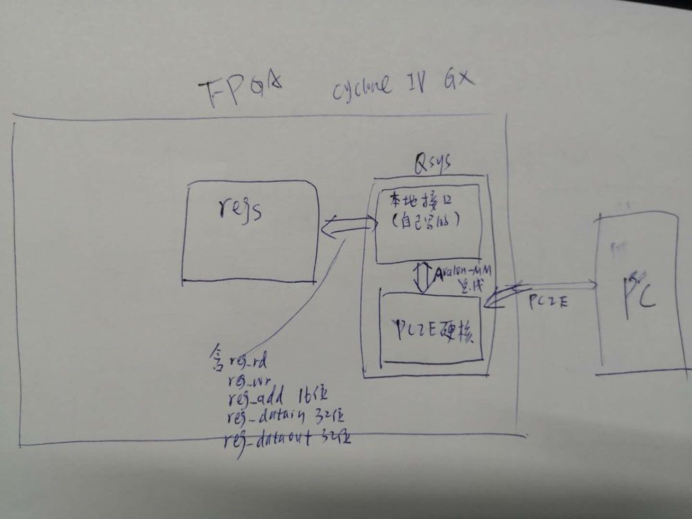

1、QSYS is used to call the PCIE core to communicate with PC, and the PCIE core communicates through the avalon-mm bus and the local interface (self-programmed), which can realize subsequent data reading and writing, and the corresponding address of all data is offset by two digits.

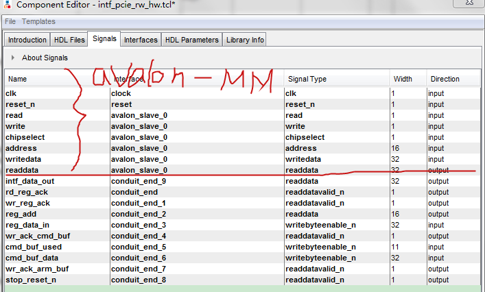

2、I wonder if there is a place to set in the driver.Or maybe I'm using the wrong Avalon bus。
3、here is another possibility. Is there a 2-bit offset in the address of PCIE?

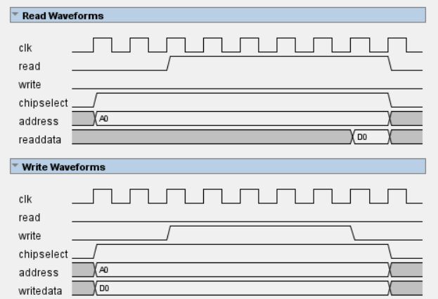

Hi, In order to better assist you, it will be great help if you can descript your questions in detail. If you would like to understand more about the Avalon specification, I would suggest you to refer to this link: https://www.intel.com/content/dam/www/programmable/us/en/pdfs/literature/manual/mnl_avalon_spec.pdf Regards -SK Lim
