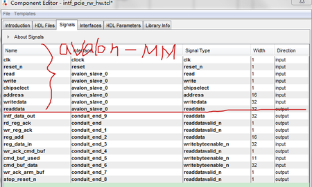

1、QSYS is used to call the PCIE core to communicate with PC, and the PCIE core communicates through the avalon-mm bus and the local interface (self-programmed), which can realize s...
